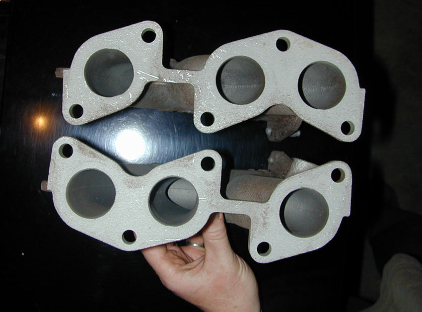

For comparison, these are pics of the stock exhaust manifolds/headers:

I'd say that those are for the EG33, but the primaries are way too short to make the header beneficial. Minimum useful length would be 36" (and they should all be equal length). 40-50" primaries would be better but I don't think there is any where to fit them under the car.

Not only that, but the design of the Outback Motorsports primaries is smoother flowing than the stock exhaust manifolds (just looking at the design w/o knowing the ID of the pipes).
If you look at the design of the factory manifold on the right, the back two primaries first move towards the front before taking a bend and flowing towards the back of the manifold (where the header pipes are hooked up).

I can honestly say I do not believe they will be any kind of an improvement... Just look at the bends in the pipe and then take a look at the stock headers... Our manifolds have nice swooping curves as opposed to these with sharper angles...plus they are not even a direct bult up... you would need and entire new exhaust system to support headers that prob will give you next to nothing
