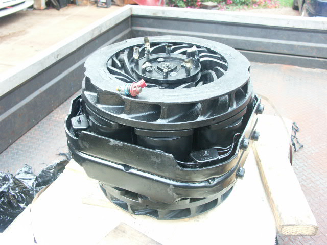

The retarder was delivered, as they say its a big mother. I put an injector so you can get a idea of the size.
Tony

It does look like it could dissipate the heat OK, if it is feed plenty of air.
