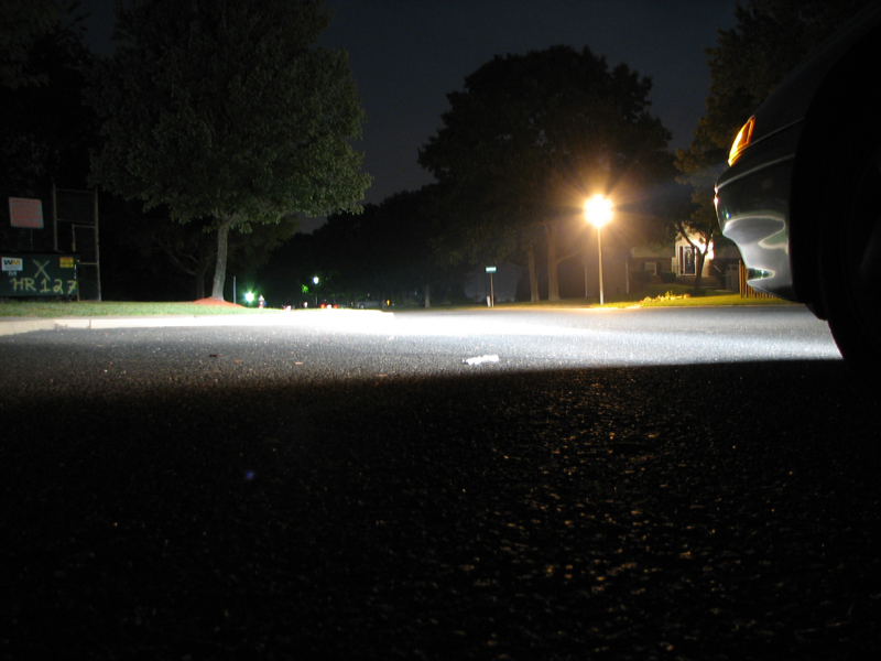

Tim 08-27-2005 07:09 AM
http://www.subaru-svx.net/photos/files/TE1221/28712.jpg
I'll try and take a pic to show cutoff, but it is a general idea
