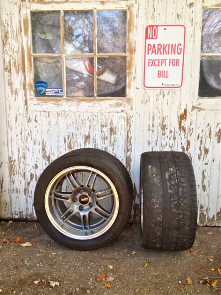

SVXRide 11-26-2013 12:20 PM
Re: Lowering Springs
OT's FP-class SVX RaceCar is now running 17x9 Mustang rims with Hoosier 295 A6 tires.
My FP-class SVX RacerX will be running 17x10 Mustang rims with Hoosier and Kumho 315s this coming season.
Significant body mods are required in both cases. My 17x10 rims have +20 offset, so they do have some "dish".
Bill
