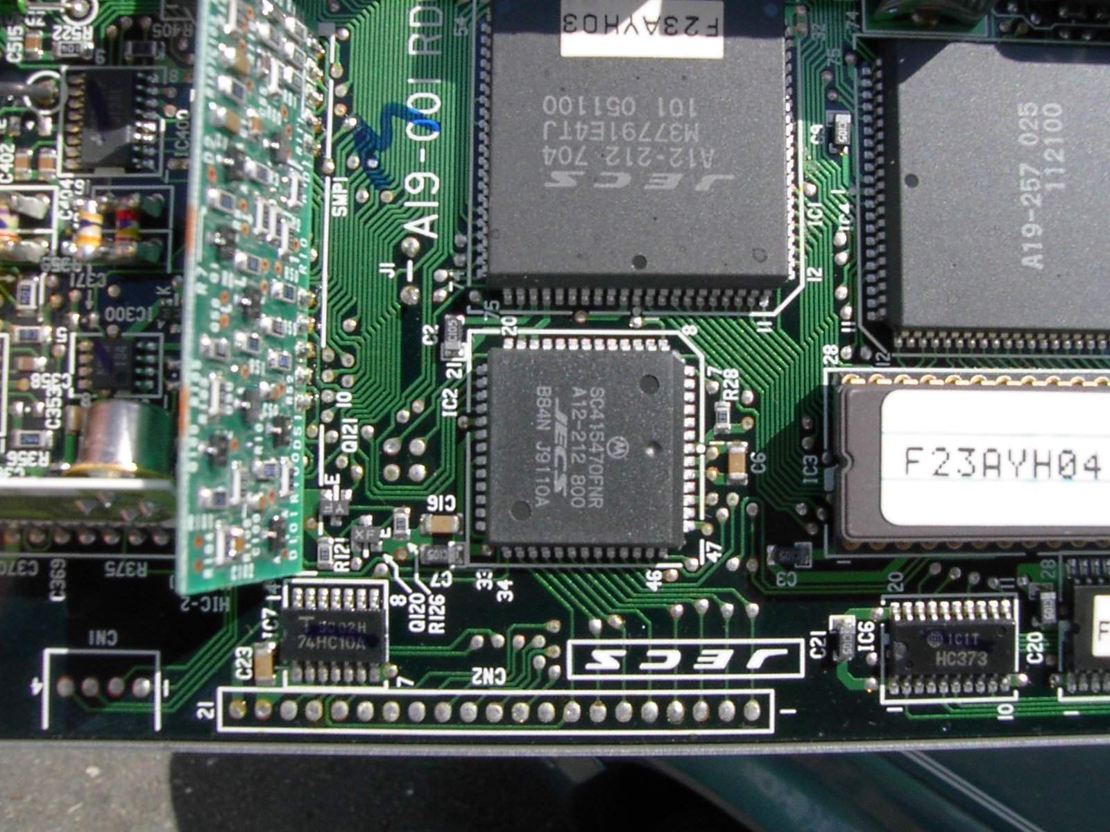

tuzem 08-23-2003 01:17 PM
HELP HELP HELP!
I just got the ECU off and I have no clue which of the damn resistors I need to cut! Here is what it looks like:
http://www.subaru-svx.net/photos/files/tuzem/11342.jpg
Somebody, please help ;) Thanks!!!!
-Nick

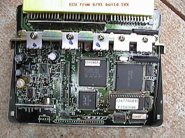

immortal_suby 08-23-2003 01:20 PM
Pics in my locker of the ECU location and internals - some may not have the bead in there to crush. This is a great mod - one of the first I did on mine shortly after buying it.
tuzem 08-23-2003 01:30 PM
Hmm... I don't have the tan and the other resistor... Does this mean I don't have the hesitation problem? Or just that I can't do anything about it??? Thanks!!!
Nick
immortal_suby 08-23-2003 01:33 PM
My wifes 92 did not have them either - see the pic in my locker. But her's did have a chip in the slot where mine was empty. Her svx was manufactured 6/91 and it does not hesitate a bit - looks identical to the ECU you have in your locker.
tuzem 08-23-2003 01:35 PM
Cool :) Thanks! Mine was also made 06/91 and has the chip. I guess I'll put it all back together ;)) Thanks!
-Nick

Motorsport-SVX 08-24-2003 10:56 PM
question
Which chip are you referring to ? can you circle it and post
a pic?
So far Ive seen ECUs with:
1 ECU w/ tan resistor (some cut, some not yet)
(whats cutting this wire suppose to do?)
1 ECU w/ tan and black resistor (with the black one crushed)
just leaving the tan one intact AND not cut...
(I know this should help with the hesitation)
1 ECU with no resistors and a chip in some ROM location
which shouldnt be touched.
Also, so this message:
"... clear the memory using the select monitor."
Hows this done ?
thanks...DG
immortal_suby 08-25-2003 06:10 PM
Here's the pic with the chip circled
http://www.subaru-svx.net/photos/fil...suby/11479.jpg
